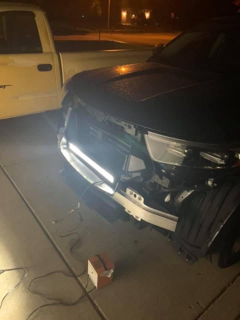

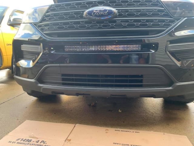

Has anyone successfully mounted a light bar behind the bumper/grill? There is a perfect slot right in between the fog lights to nest a light bar, but I haven’t found anyone online who has posted pictures of this being done. Thanks

I found these pics from a post online. Hope it helps. 8E8675E4-E781-4964-9212-CA8150DC0B5A.jpeg 868E3848-A90B-4E79-917C-B3AAEFEBAD85.jpeg

Hot damn someone did it. Thanks for sending buddy - do you have a url link?

Ford Explorer 6th gen group on Facebook, if you join you’ll be able to see the post about it. But all you really have to do is remove the front bumper and mount the light in the location in the picture.
