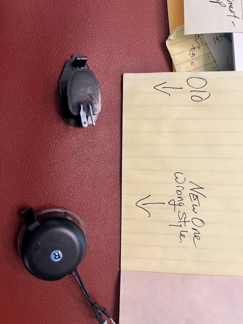

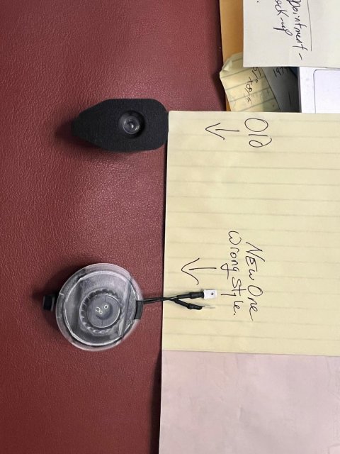

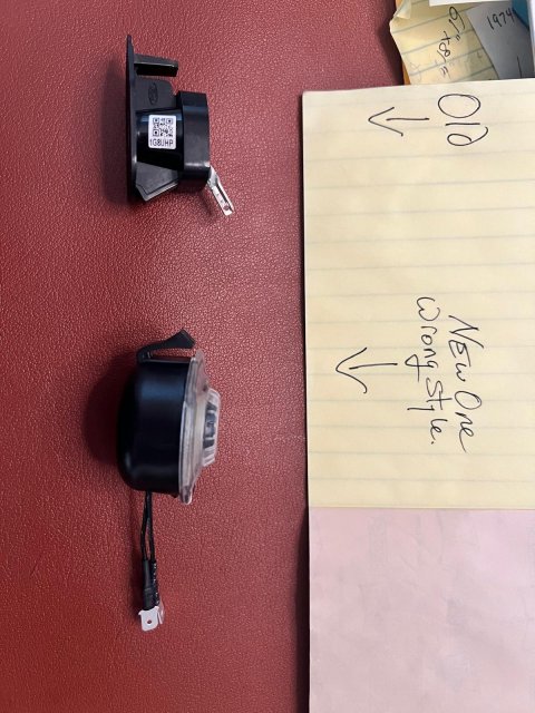

I have a 2021 ST, drivers puddle light fell out. All of the replacements on line look nothing like the one in my hand, does anyone know anything about when they changed designs. Regardless, I want to try something custom, but I don't want to throw a buch of cash at this either.

The one on my ST looks like your old one.
I'm going out on a limb here but I'm guessing the round style is the standard puddle lamp that comes on XLTs, Limited, Platniums, etc. They have a standard light that illuminates the ground while the ST projects the red logo. That's a guess however

Same thing happened to me last year, the descriptions don't really help. I even called the parts desk and he said he 'assumed' that they had "ST" as the image.
The part numbers above are correct, you want the left for driver side. Snaps right in, takes 10 seconds to install. Part #: LB5Z13B375C
