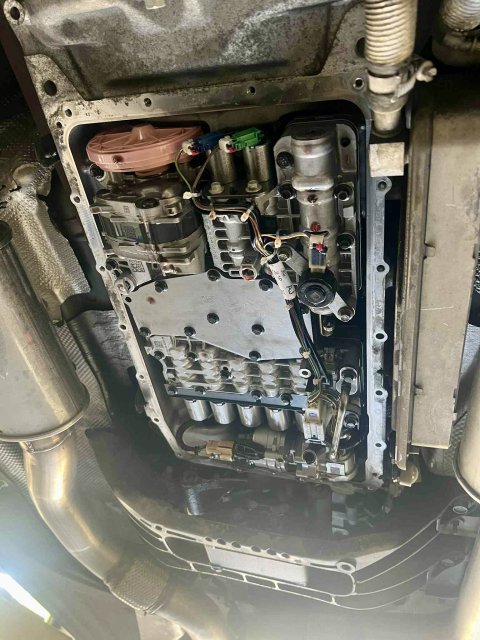

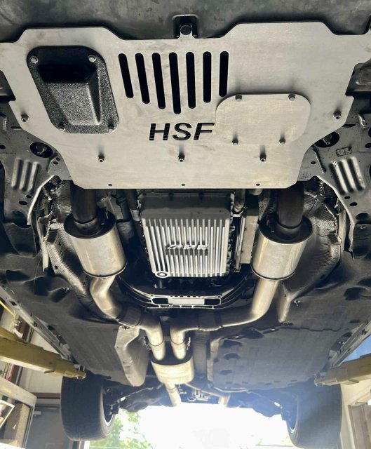

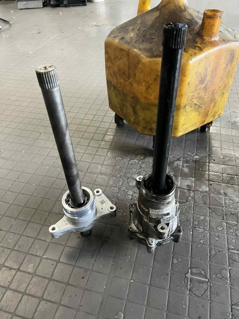

At almost 115K it was time to hit some maintenance stuff like transfer case fluid and trans fluid. Since I’ve had a little flare when hit in Sport mode I had a new valve body installed and covered it all back up with a new PPE aluminum pan. I also have the all too common FADA leak…so I got rid of the whole damn thing. Fords new delete is cheap and I’ll never get that Christmas tree dash again since it eliminates the electronics as well. It will just be full time AWD now. My buddy who’s doing the work said the old FADA o-ring feels more like plastic than rubber which definitely explains why so many of them leak. att.akD8LHTM6g-mHND1VhNMDCkcgE8LYwfNZAQUqDNyazc.jpeg att.ZMe7r4UvkRBT773XnNqdtBRWeOtgk-HC9fUceUIyerc.jpeg att.OCaE3QUcNJ6kGPSjf-0bKL_RgNNARHJQRLGgaoxKSUc.jpeg att.SzNKY0M0ZVFmo_xbr0ig89vhfTR0E5KvutyW-vGNxyk.jpeg

Pardon my ignorance x2! This sounds like something I want to get done on mine too along with all of the servicing. I'm guessing you have a shop that does all of this? I need to talk to my shop and see if my guy can hook me up. I am just over 70k miles on mine. No issues but I want to do preventative maintanence as I run up and back from SoCal a lot and dont want to get stuck in the middle of the state. Another question....what's the difference in the two axles in the one picture?

The FADA delete requires one new axle shaft…obviously it’s shorter. Surprisingly the hard parts are really cheap. Not surprisingly the labor is not…it’s a lot of work. There’s a local shop I’ve used for over a decade and the tech that works on my car there is a fellow ST owner and enthusiast so it works out very well.
