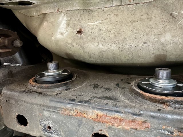

Added the JXB diff insert and stiffer both yesterday. Easy install, hardest part was getting the bolt torqued with very little room/leverage. (And yes I know the insert text is upside down, didn’t notice until I looked at the pics :ROFLMAO::ROFLMAO: )

Can anyone with the double JXB inserts comment on the driver's side (left mount in the picture above) of mine? It sticks out quite a bit more than the passenger side. Torqued to about 140 ft lbs which is about all I could manage laying flat on my back with no real leverage. Just seems odd.

Was there a difference between the left and right inserts? I see they have different part numbers. It sure doesn't look correct. Have you tried contacting JXB?
