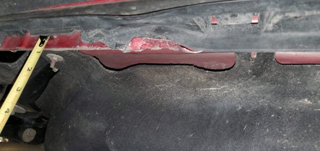

Thanks to STJIM for bringing this up as it got me under my ST where I discovered that some dealership shop genius also couldn't figure out those (when you're under the side) well marked lift points and put their lift pads 4 inches forward under a (Not Intended for lift) area and damaged the protruding tab along that body/floor pan seam folding it over and cracking off paint. Damaged Body tab from Improper lifting of Explorer.jpg
Tape measure is in the proper lifting point section.

Ok, just went and checked mine, They seem to have placed in in between the arrows. However, it is a thin portion, not a flat one. Is it where it is supposed to go. I am not sure if I am being clear with my question, it is like a thin metal area, like the folded edge protruding downand Not a flat one like I expected.

The lift points are that edge you're looking at, if you look at the top of the Ford jack, it has a groove for that edge, the Potauto Adapter allows standard round plate topped jacks to lift without damaging that standing seam.

Ok, thank you, then my seam is slightly damaged, it has a split in the seam on one side. Either they should change the jack design or change the mounting points.
