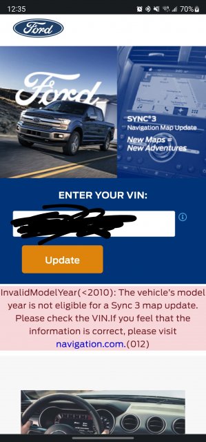

The sync website says my VIN is pre-2010. Has anyone else gotten this message?

You may need to wait up to a year before doing a map update. I and others with 2022 models had the same problem. I seems that VINs are not loaded into their data base for map updates until much later. I had mine for nearly a year until I could do that. One day suddenly everybody with 2022 models could get the update. The updates do not come from Ford, but are from a third party. If their system does not have your VIN it just says your vehicle is not new enough to get map updates.
