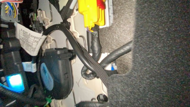

Hello all
I’ve been noticing my cooled seats don’t cool that much, if at all. I remember reading about the intake being blocked from the factory. Is this the fan motor? To the “right” I can feel lots of air blowing out. And, it doesn’t seem to be for the A/C since it doesn’t blow towards the back. But, to me, it feels like this should be connected to something or that something is blocking the exhaust and it’s getting redirected to the input. If that makes sense. Lol.

Yes that is the fan. I believe it is meant to extract warm temperatures away from the seat rather than blow cool air into the seat.

I know this is old, but if you haven't fixed it mine started to do the same thing. The fan is connected to the seat with a twist lock system with three tabs. When mine came loose it got loud. I put it back on properly and it works fine now and is quiet.

I never read the sticker when buying my ST but look at yours does it say "vented" or "cooled" seat? there is big difference. obviously vent is just air and cooled is AC seats. Lots of cars are just vented.

from my quick google it says Vented seats. new vented seats pull warm air away letting you cool naturally. So no they are not cooled seats from my quick search at least

My 2021 sticker says Heated/Ventilated.

thats what I found also vented. so they will not push AC air thru.
typically vented seats will push air thru the seat but the Explorer says it pushes air away from you. I will be looking under there today after work. I am curious this push air away how or what they are doing.
I am brand new to the ST and no real hot days here yet so I have not noticed. I will not buy a car without at least vented seats But I prefer cooled

I finally got it looked at when I dropped it off for an oil change. They said a few fans needed to be replaced.
