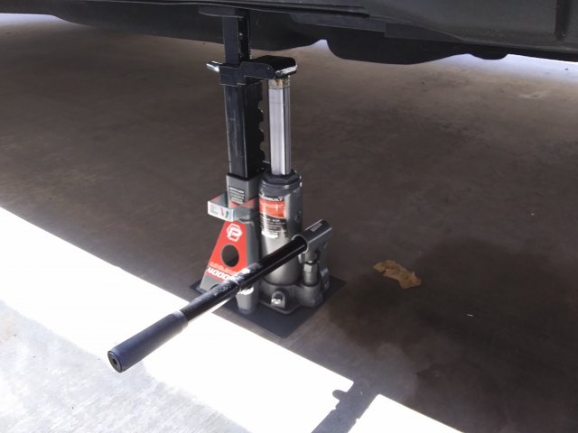

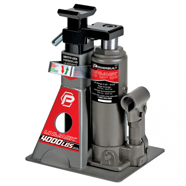

You can do both:

However, with that said, I found the best method is to put the jack just inboard of the pinchweld, but up against it. The structure there is almost 1/4in thick. You can find the thick part by poking a finger through one of the holes down there.
Edit: Don't bother buying the rubber pinch weld pad that is offered with that jack... It will get cut clean in half pretty damn quick. I returned both pieces for a refund.

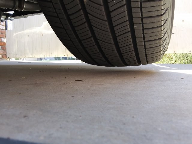

Those look convenient. Do you get enough lift with them? The other bottle jacks I’ve used don’t raise the truck enough to get the tire off the ground
With the pin in the 4th or 5th hole:

I'm going to get a second one. If you lift one end as shown in the pic above, it will raise the other end enough to get the pin in a lower hole & then you can get that wheel 4in or more off the ground with a second jack..

That's awesome. Would make quick work of lifting and supporting for those of us without the nice toys like Cruising68 has ;)

Planning my first tire rotation on the ST and considering one of these UniJacks... but if I'm understanding correctly, you still need a second jack to jack up the vehicle enough to get the UniJack under it with it's jack stand extended to the 4th hole... so that THEN you can use the bottle jack on the UniJack to lift the vehicle the rest of the way. Is that what you guys are doing?
According to Amazon, the piston on the UniJack only provides 5" of lift travel from wherever you initially have the jack arm set... not enough to get the wheels off the ground on an ST using this jack alone. Or am I missing something? Can you jack the tires off the ground using only a 2 ton UniJack?
