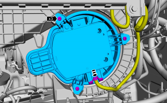

I have 34k now, but it started to become noisy right around 20k miles. I just lived with it by turning the AC or radio up to block out the sound.
Fortunately it seems like an easy repair. 3 bolts and it’s out from below so no disassembly of the entire dash.
for those out of warranty, it appears to be a $500 part.
