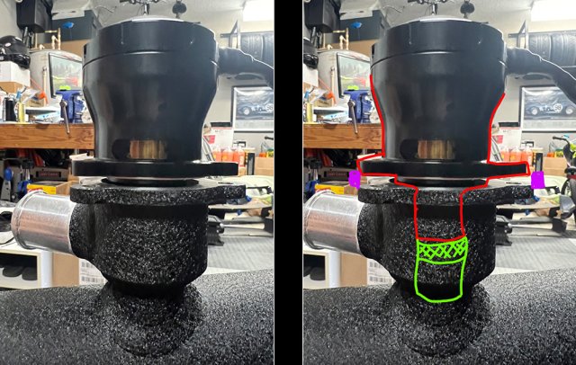

I just finished an install with a CVF intercooler and pipe upgrade (cold side and hot side) kit on my 2020 ST, with a Turbosmart Dual Port BOV part #TS-0223-1096.
I ran into a problem with the pipe kit.
If you are thinking about using this pipe kit from CVF (Part # CVF 1921AEXPICKIT, this is specific to the 2020 version, that has a BOV flange), before you get stuck in with the install, make sure the BOV you want to use fits on the boss. Mine did not (which I didn't discover until halfway through, which is about the worst time).
The issue is this: the Turbosmart BOV center pillar thing is solid, it does not move up on a spring like the OEM one. When I put the BOV on the flange, it would not sit flush with the mounting surface. (I'll post an image at the bottom of the issue.) This happened because the mounting surface on the flange of the CVF pipe was too tall. It was taller than the stock one by a little over 2mm. And because the center section of the TS is solid, you can't push it down any more. There is physical interference. Even with the o-ring removed from the central pillar, it was nowhere close to sitting flush. So before you start the install,
A note on the stock BPV -- it would sit flush on the CVF pipe kit, but it did so only because the center section is what moves up and down to vent. What this means is that if you installed the OEM BPV, the center section would already be "lifted" by about half, and I have no idea what the OEM electronics would make of this. I don't know if it would sense that the BPV is "stuck open" or something. When mounted on the OEM pipe, the OEM BPV center section was not "lifted" at all.

My Solution
So what I did was take my CVF hot pipe, the OEM pipe, and the TS BOV to a machine shop. Showed them the issue, which they immediately understood the problem to be what I am describing here, and nothing to do with any o-ring on the TS BOV. They chucked the CVF pipe into one of their machines, and removed material from the central pillar. And guess what. The TS BOV fits now! As does the OEM one, without "lifting." The machine shop was able to turn the job around same day.
TL;DR
At the end of the day, everything is back together and working. No issues. The quality of the CVF parts seems really good. The issue is they jigged the hotside BOV mounting part wrong before welding (or just measured wrong?), so make sure you test fit before tearing your truck down if you are going to do this. Otherwise, no issue with the kit. Minor complaint is that they don't include instructions, so you have to waste some time playing the guessing game with which clamps go where -- it's annoying and it would be super easy for them to provide a legend. But they don't for some reason. You have to watch an HSF (not even affiliated) video to see how to install this kit.

Here's that picture of the mounting problem: on the left, the un-marked picture (TS BOV on the CVF hot side pipe), on the right, same picture but with my markings: RED is the outline of the BOV, GREEN is the CVF central pillar (red and green are physically touching in this picture, without an o-ring between them -- so with an o-ring between them, the gap would be even larger), the PURPLE is the resulting gap, that is supposedly fixed via an o-ring, somewhow. :unsure: The GREEN HATCH section at the top of the pillar is essentially what the machine shop cut away, which allowed the BOV to sit flush to the flange.

Okay, well, a couple things:
  1. Which o-ring are you talking about? There's a small-diameter one on the central "pillar" and a large-diameter one that goes around the flange. Which, specifically, are you referring to?
  2. You are saying it's okay to leave this BOV mounted with a +2mm gap between it and the mounting flange of the hot pipe? That means the bolts that hold it down are pulling against two faces that are not in contact with each other -- this will put A LOT of stress on the bolt holes of the BOV and most likely will bend them and/or crack them. There is no way this can be an acceptable mounting solution. If this is how CVF expects it to be mounted, spacers should have been provided.
  3. As it stands, it absolutely does NOT seal, if I had purchased the Bypass version of the BOV, it would be venting to atmosphere and not through the hose -- while it may not matter to the engine whether it's atmo or recirc, if I intentionally bought a BPV to recirc and it vented to atmo because it doesn't actually mate up properly...that's a problem.
  4. If I am indeed the 742516394936th person to have an issue with this, that sounds like CVF has a problem with their product and needs to address it. ‍♂️
  5. It absolutely is an issue. At a minimum it's poor fitment. How can you say this isn't an issue?

I say it isn’t an issue because everyone else isn’t having any functional issues with the exact same fitment. If you wanna bitch and moan…go for it.
I don't understand why you are being a jerk about this. Do you work with CVF or something? Is it run by your brother-in-law? It's a really bad fitment, why are you defending it? I am completely baffled by your response here.
There's clearly an issue, the BOV does not even come close to sitting flush on the on the flange. I'm not bitching and moaning about something insignificant -- it clearly doesn't fit. The machinist I took it to, who's not even a car person, immediately recognized the issue. It's a manufacturing issue FFS, and just because you are an internet forum hero here and are apparently okay with a shit fitment, doesn't automatically make what I am saying here pointless or irrelevant, and I really don't appreciate you trying to brush it -- and me -- under the rug.
Furthermore, this gap affects the functioning of the unit. If you think it doesn't, then you are misunderstanding the actual issue I posted. Now, maybe there's a wide swing of tolerances in the pipes due to poor quality control, and maybe not everyone else's is like the one I received. But that doesn't mean my issue here isn't a thing. It is. There's photo evidence.
Look at the gap in the picture. That is completely unacceptable, I don't care who you are. There is clearly a defect in the dimensions of the product I received. Why are you being like this?

When you try to fit aftermarket parts on top of aftermarket parts, sometimes shit doesn't fit. My TS BOV and CV Fab hot side pipe had a very small gap between the flange, much smaller than yours, and on par with what everyone else has seen with this same combo. My O-Ring was in the hole, so the small gap wasn't a big deal.
A small gap I could totally understand -- the small diameter o-ring that sits on the "pillar" was pretty fat, so I could see how reducing that in thickness just a little would make your situation sit flush.
I want to reinterate here that the gap I'm showing in my picture is WITHOUT the o-ring installed. That's just straight metal to metal. If I had put the o-ring on, the gap would have been even larger.
So I guess in my case, as I sort of expected, my particular pipe was manufactured incorrectly, probably put in the jig wrong before welding. It would have been super if CVF support would have listened to my particular issue and offered to send a replacement. I would have been fine with a small gap, I could have fixed that with a different o-ring.
Also, it's worth pointing out that the Turbosmart fit perfectly on the OEM pipe. So this issue really has nothing to do with Turbosmart, and everything to do with CVF.

Anyway, to sum up for everyone, the kit from CVF is fine other than the BOV mounting issue. If you are buying the kit for later-year STs and/or aren't doing the BOV, then I don't think you'll have anything to worry about. Things fit together just fine.
If you are doing the BOV option, or want to add it to a later-year ST, then definitely to your test fitting in advance, and be prepared to take the pipe to a machine shop or whatever for corrections -- or you can attempt CVF customer support at your own peril.
