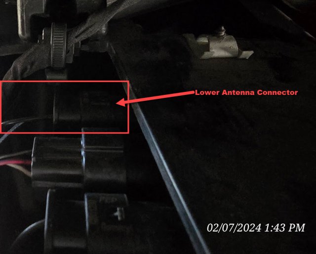

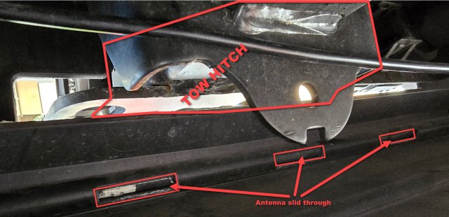

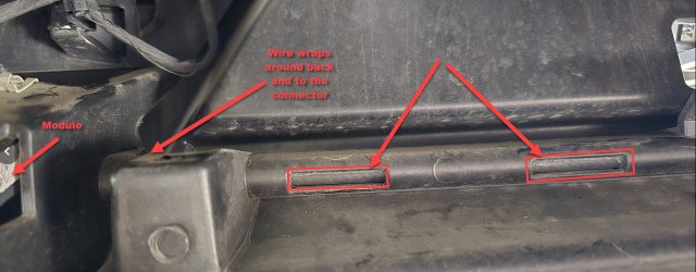

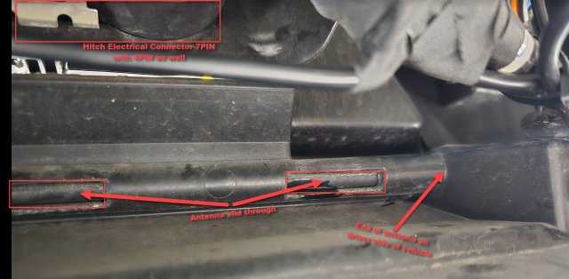

In the pic, it shows the control module under the bumper, under the passanger side. If you just get on your back and slide under, you can see everything, the bumper vallance hangs down and you can pull it a little bit to get room, but you can feel for all three harnesses being there, and the bottom one snaps in and a short cable that runs to a place in the rear valance to slide in. It says if you have a tow hitch, it is two antenna's, but maybe that is another body style, like the XLT or Timberlain. Mine, the antenna goes all the way across under the tow hitch. (Second Pic)

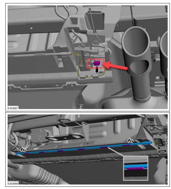

Thank you all for any help! Below is the link to the manual for the 20-24 explorers I found.
https://www.foexplorer.com/ford_exp...ree_liftgate_actuation_lower_sensor-1200.html
