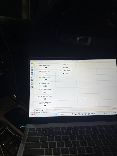

If you can use Forscan on a computer and log data live with the oscilloscope feature, this would tell you more. The AWD module needs to see close to 12V with engine off and 14v with engine on. If you see 8-10v with engine off or 8-12V with engine on, then you likely have a bad ground. Otherwise if the AWD module isn't being found at all in forscan then your ground might be completely failed.

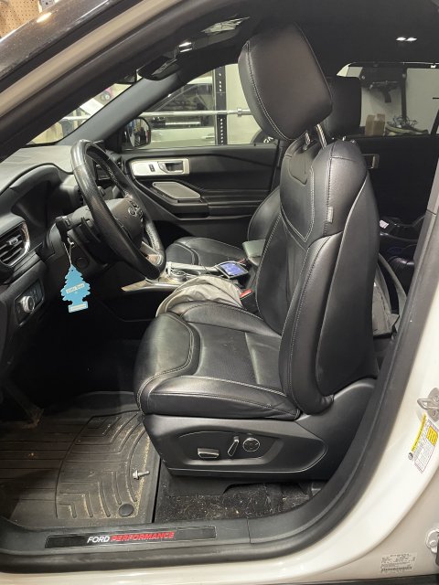

Move the backrest all the way forward so it fits through the door. Then move the whole seat all the way back to expose the front frame bolts. View attachment 32000
then remove the plastic covers and unbolt. It’s 13mm.
Then move the seat all the way forward to expose the two rear frame bolts. Remove the plastic covers and unbolt. 13mm again. an extension will help.
View attachment 32005 View attachment 32004
now the seat is loose but there is two cables you need to worry about before moving the seat out.
before disconnecting the connectors you need to move the seat halfway forward so the frame rails fit nicely under the butt of the seat. This just helps you fit it through the door. Then disconnect the negative terminal of the battery so you don’t throw a bunch of codes for tampering with the electronics.
View attachment 32014 Under neath the seat up under the butt, you have a chunky connector. Press into the connector in the center and there is an arm you need to swing out once the center is pressed in. It’s pretty easy once you figure out how it works. View attachment 32007
that body harness is also secured to the seat with a plastic clip so you need to pry it out of the mounting hole.
the following cables look aftermarket and bunk as heck so I don’t know if you will have them… but if you do, cut all the zip ties and expand the cable to it’s full length. There is NO connector to disconnect here… thankfully my cables were super long so i was able to remove the seat still with it attached.
View attachment 32012 You’re ready to remove the seat now. Optionally you should be able to just push the seat back onto the second row if you fold the second row down. If you proceed to remove it entirely, Be careful not to scratch the plastic trim on the floor or the B pillar. Maybe put a blanket down! It’s heavy but doable alone.

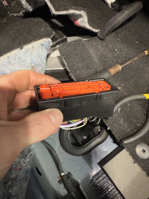

press this center tab and then swing the arm out. Pull the connector off.
this is the pin you will want to depin if you plan to follow my same method of soldering the 14awg wire to the pin.
to remove the red locking Block, it’s not too bad. Use a small flathead to get under the red inside the channel and pry it up. You should squeeze and apply hard pressure with your other hand to the outside of the black housing to help prevent breaking it when prying against it. I broke mine in a few spots but the connector still operates and locks on very good. So it’s not life or death here if you crack something. There are two little channels where you can put the flathead into and there is a good way to get under the red. Use those sides first since the other two of the 4 channels dont give you as mich of a ledge to catch with the screwdriver. It’s really not too bad i thought it was going to be a lot harder.
once you get the red block out, this housing comes off easy. Remove it by pressing this tab and pulling off.
to depin the black and white ground wire pin, its pretty easy too. In between the top and bottom pins you can see the little locking tab deep down holding it in. just pry the plastic tab away from the pin and pull the wire from the back and it will come out. You will want to cut and peel the electrical tape and wrap the factory puts on, expose as much wire as you need. This is how far i went:
i opted to save the red seal thing and just jam the wire through the center. I used a sharp spike tool i had and inserted it through the center and then fed the wire through after the spike. I dont think you need the rubber seal it just helps with corrosion and strain relief but this connector shouldn't see harsh conditions so do what you like.
Solder the new wire to the pin and keep the old wire there. Get it nice and hot, make sure everything is flowed nicely, dont leave a cold joint. Thankfully the connector housing gives you a lot of room for the extra space the solder and wire takes up.
insert the wire to it’s home in the connector listen for the snap of the locking tab, pull to make sure it is secure.
Press the Red locking block back in, it will snap nicely.
Now you want to just give the wires some slack and electrical tape up tightly back to the body harness make it look nice and this will help protect the wires at the pins. Then reinstall the housing and zip tie it on again. just put it back how you found it basically. Check the connection from the AWD module case to the wire you just added.

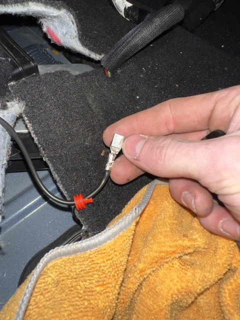

Then you need to crimp and heatshrink the ring terminal. Measure out how much wire you need and zip tie it in a few spots to the factory harness. You also need to sand the paint (and underlying primer) to expose raw metal on this beam. This is where you will insert your m6 screw and ring terminal. There was no threads in this hole for me but after screwing the bolt in i was able to torque it really well. View attachment 32031

Verify with forscan that the module is getting 14v with engine on and that the transfer case actuator is working. You can clear all the DTCs and verify they don’t come back. Enjoy the car! View attachment 32033
