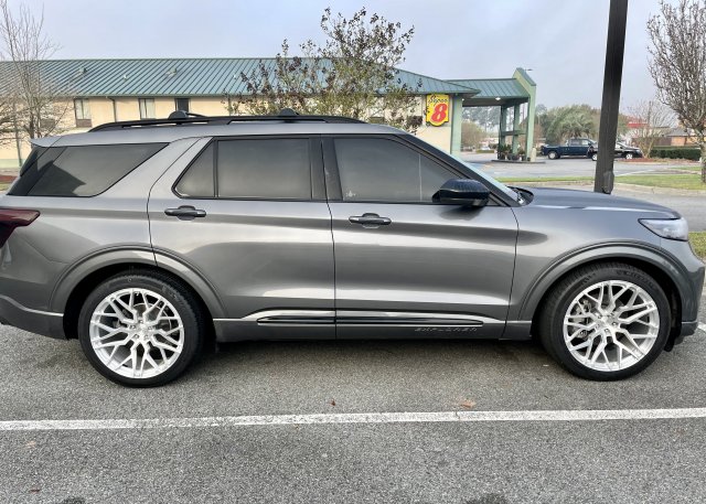

Full profile in the sunlight. Looks so much sportier with the Steeda springs and 22” BC Forged wheels.

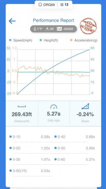

Unfortunately I didn’t have time. Had these performance mods done right after those runs above:
- Whipple IC
- AFE CAI
- Lighter wheels
- Corsa exhaust
No tune yet though. Apparently Ford Performance calibration doesn’t work on 2023 STs yet. They said it should be out in the next few months. My best 0-60mph so far with just those mods is 5.27. I’m disappointed that with the cooler engine plus those mods I’ve only shaved .25 seconds off that time in the exact same place with similar conditions, though it was probably more humid. Maybe she needs some time to break in with them? We’ll see.

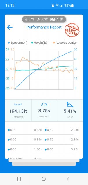

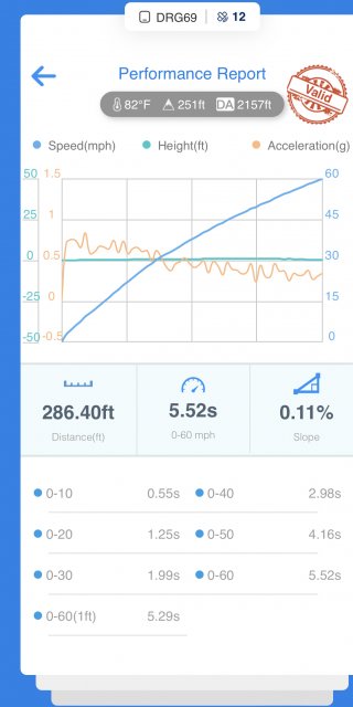

I should mention, the ST's will run E30 from the factory. Most vehicles from around 2015 on will run E30 from the factory. You won't gain much if anything from the factory tune on E30. You will need a tune to take advantage of E30. The show engine masters did a test on various forms of intercooling and concluded that ethanol is the best intercooler you can get, that's why boosted engines like our twin turbo v-6 works so well with E30, E50, or even E85. Some tuners charge extra for an E30 tune or E30 capabilities built into the tune, ZFG does not. All of his tunes that are not E50 or E85 specific have the tune optimized to take advantage of E30. The tune will self adjust for any mix of ethanol from E0 to E30 or anywhere in between. You can get an E50 tune, but then you must run E40 to E60 all the time with that tune. The E50 is for max performance on the factory DI fuel pump and injectors as the factory pump can not supply enough fuel to go any higher in ethanol concentration. Once you upgrade the pump and injectors, you can get an E85 tune and those are for E70 and higher and you must maintain that concentration with that tune.
I run a 93 tune so I can throw a little ethanol in the tank and have some fun when I want to, then just run 93 the rest of the time. In my area the 93 has 10% ethanol and the E85 is actually E73-74 so with a 20 gallon tank I put in 6 gallons of E85 and then fill the tank with 93 and that gets me real close to E30.
View attachment 16713 View attachment 16714
