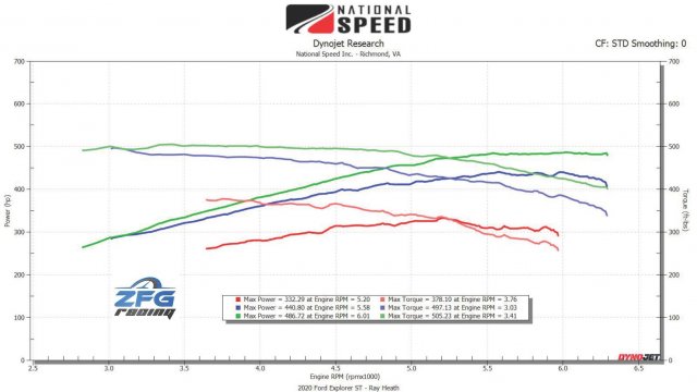

Here's an actual dyno of a ZFG tuned vehicle (LokiWolf) completely stock other than the tune. This is a great comparison since it was done on the same dyno, on the same day with Stock tune, 93 tune, and E50 tune. These are all WHP numbers of course. Assuming stock was 400 crankshaft HP, you see a drivetrain loss of about 68 hp. With that in mind the 93 tune would equate to over 500 crankshaft HP. You cannot use a percentage to calculate drivetrain loss.

It's true, with no other modifications, drive train loss is essentially a constant. That said, with the same after Tune, 68 crank to WHP loss, to achieve the desired 480WHP number the tune and the intercooler would need to add perhaps 140HP.
Given just the IC and the Tune (weighing heavily on the Tune), I don't see it happening. I'm not saying you can't crank the calibration of the Tune to achieve higher, but in order to support the desired numbers, I believe other goodies will be needed. Then add to the equation, a dependable, 30K/year, daily driver...
@TMac, I'd be interested in reading what type of HP at the crank, you see needed to net 480WHP on an ST.

We can see on the dyno above that it cost approximately 68 hp to convert between crank and whp. (400 crank - 332 whp = 68 at least on that dyno in whatever gear the pull was made). So, in this case (and remember every vehicle will be slightly different), we can add 68 hp to arrive at a crank hp level. So on 93 440 whp would be approx 508 crank. 486 whp on E50 would be 554.
For those who think that drivetrain loss equals a fixed percentage of crank hp, here's an analogy. Let's assume I pull out the ST engine and replace it with a 1200 crank hp supercharged Coyote engine. Since 68 hp is approximately 16% expressed as a percentage of the stock 400 crank hp, that would mean we could apply that to the 1200 chp engine. Does anyone seriously think that drivetrain losses will now amount to 192 HP (.16 * 1200)? And what force would suddenly cost us an additional 124 HP (192-68)? Perhaps we might introduce some additional friction via lubrication shear or thermal load due to same, but it certainly wouldn't amount to 124 extra HP.

In case anyone is still reading (lol), someone might also say, yes, but what about the F=MA? Since we're increasing the (A)cceleration of the components doesn't this affect the loss? Well, that's covered because (M)ass stayed the same, which means we increased the (F)orce. It has nothing to do with parasitic losses of gears, axles, pumps, etc associated with "drive train" losses.
But all of these HP comparisons are simply calculations of measured torque at a given load. So you have to compare apples to apples. A dyno chart (like I posted earlier) is great to measure the result, but it's not an absolute except for the dyno bench racing crowd. Look at it this way- if you gained 100hp, you gained 100hp!

I would tend to agree with that assessment. Power loss is mostly due to friction (I'm not an ME though) and I imagine would remain constant for a given drivetrain configuration. So I would assume that a platform like RWD would have less friction due to less mechanical transfer of power than AWD/4wd and therefore less loss at the output for a given input. Like you mentioned, if you suddenly replaced it with a Merlin V12 from a Spitfire, you wouldn't lose 16% of that output due solely to drivetrain loss. She might be a little nose-heavy though, careful in the rain haha.
