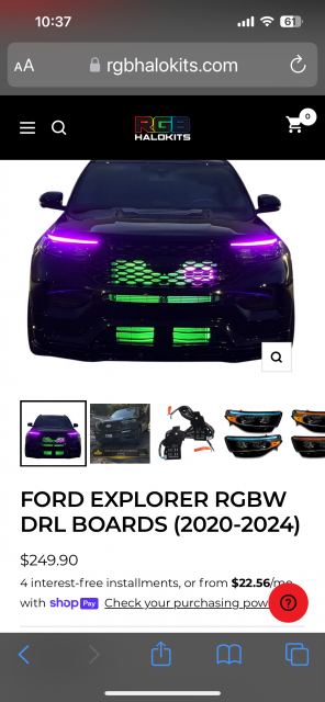

Has to be a wiring issue. Also, another alternative since Ford only sells complete assemblies, is to get this DRL RGB kit and bake open your headlights and replace the DRLs with these aftermarket ones. Plus they’ll look cool. IMG_2766.png

Has to be a wiring issue. Also, another alternative since Ford only sells complete assemblies, is to get this DRL RGB kit and bake open your headlights and replace the DRLs with these aftermarket ones. Plus they’ll look cool. View attachment 24161
Ya I saw these while looking through articles. That's pretty neat! Thanks everyone for the help.
