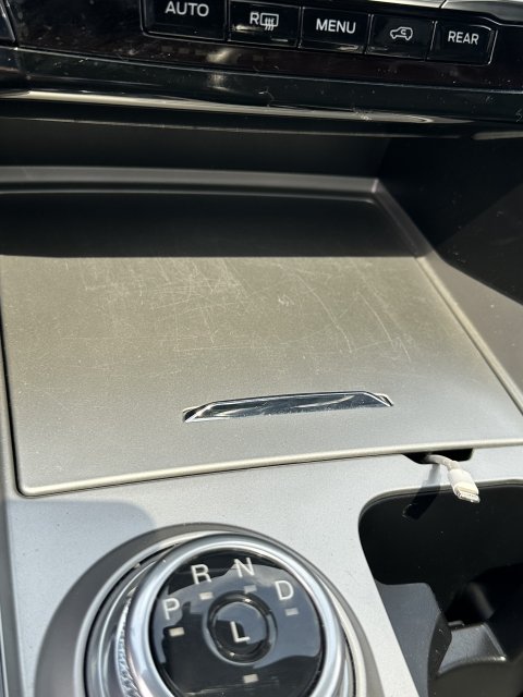

Front center storage cover
Flint MI
Just picked up a 2022 Platinum. This center cover is scratched to crap. I don’t see where they sell just the cover so I bought the entire storage unit with cover from eBay. Has anyone replaced this? Looks like I may have to remove the entire storage unit? I don’t see where I can get to the side screws for just the cover.

Part arrived today. It took me about 1 1/2 hours. What a project. I had to loosen the entire center console
and slide it back. Then the top half of the center console would pop off. Once all the wires are disconnected, I was able to work on it outside of the car.there are 4 screws holding the entire assembly on from underneath. Transferring the cigarette lighter was the trickiest part! Lol. I could do it again in half the time. There were a lot of “WTF’s” and “please don’t break” haha
