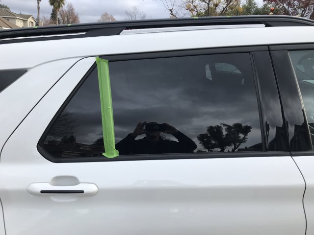

The dealer changed out the weatherstrip but that was not the fix. After several test drives I put painters tape between the stationary and movable glass. See picture. No noise at all after driving on the freeway.
I hope the dealer can change out the stationary plastic piece to fix the problem.
