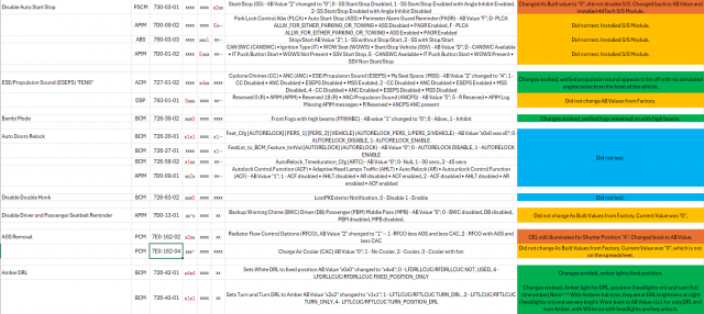

Here are some things I have been messing with. Confirmed a couple, and others were a lost cause that I could not figure out even after hours of pouring through the spreadsheet. I know there are people smarter than me when it comes to this. Hope it helps.
