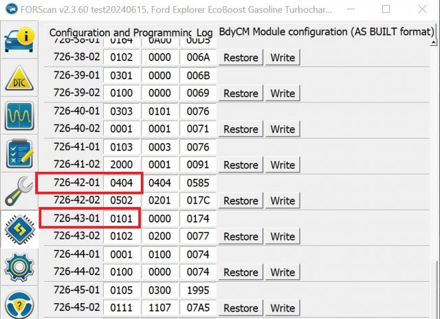

2020 ST and I turned on the amber DRL's with no issues and now I am trying to turn off the white DRL's but I am getting an Incorrect checksum warning. Totally afraid to click the YES to continue. Do I just need to click YES?
Changes are as follows:
Additional Change : If you don't want the White DRL
Module : As-Built Modules BdyCM
Change : 726-42-01 x4x4 xxxx xxXX (original value was 0303 and new 0404)

Don’t be scared. Go into the coded format and save the original version. If something messes up just load the stock file.
Anyways, there a bit more to it than just changing those numbers to get the strip off.
x0x0 is white DRL off at all times
(726-42-01 = x0x0 xxxx xxxx)

Hi Guys,
Any help for me. I tried to enable the Amber DRL using info from prior posts in my 2024 ST but for some reason it will not work when in park/neutral/drive - auto headlights, etc...
726-42-01 x4x4 xxxx xxXX - Sets the White DRL to fixed position, meaning they're dim when the headlight is on, and off when the car is in normal drive mode, daytime.
726-43-01 x1x1 xxxx xxXX - Sets Turn to Turn and DRL
Curious if I am doing something wrong. I can get the DRLs to come on however no solid Amber.
Thanks for any possible guidance.

Hi Guys,
there is more to it than just changing a few numbers….theres about 7 things that need to be changed

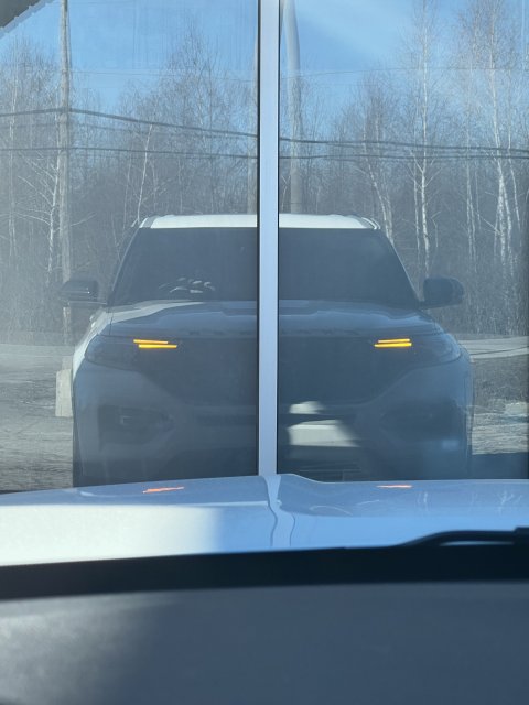

it’s actually very easy.
Amber DRL / NO white DRL
(only works during the daytime, when your lamps turn on automatically at night you will have NO DRL, all other functions will still work completely):
726-42-01 x0x0 xxxx xxxx
726-43-01 x1x1 xxxx xxxx

Does this mean that when amber DRLs are on during the day they also function as turn indicators?
I made a bunch of changes and found that whatever i messed with it would enable the amber at 100% brightness when used as DRLs - which means you can't tell they are flashing when turn signal is engaged.
Then you did something wrong.
mine are on during the day. No white strip, and function fine as turns aswell

Hello, I am new here but only in regards to Forscan, I have turned off my white strip leds aobve the headlights and now I'm hoping to get the amber parking lights, however, when I enable them, they come on and they are very bright but when i use turn signal, they do not signal only stay solid amber. Is there a fix for this, I would assume so since interceptors have similar parking lights with only amber but their turn signal still operate. Please let me know if anyone has figured this out?
