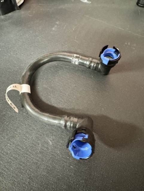

It is possible they left the PCV hose off from the plug install, they might have moved it out of the way. If they broke the clips that would cause the hose to pop off. Check the passenger's side valve cover and see if you can pull up on the hose.
Two cylinders is interesting, did they check the gap before installing the plugs?
