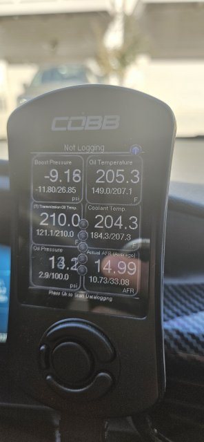

Thanks. I recently saw about 210 for all 3 after doing some pulls and sitting in traffic. It seems like they're all in operating range, but I feel like most people run a bit cooler.

I think these are all within normal operating range...but this was after a short 15 min drive with a few pulls. It just seems high for what I didm
2,064
1,441
All well within range. Trans fluid is good to 220-225 before thermal breakdown. My coolant gets over 200 at times. I wouldn’t worry about it.

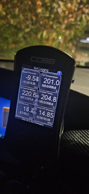

I was on the highway for about 45 min, going 65 to 95 at different times, with a few WOT pulls. I was around 200 to 210. After I got off, temps climbed to 220 as I sat at different red lights and drove about 30 mph in between them.
I know I'm still in operating temperatures, but it seems a bit high. I hear about other people who never see higher than 180. I wonder what is causing the difference.

After driving some more, I've observed that my temps are just fine on the highway, but start to rise once my speed is reduced. I think my radiator fan might not be working, I'll have to look into it.
