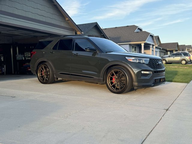

Have had the Eibach PRO-KIT #E10-35-051-03-22 lying about since last summer, and with my replacing Explorers twice, never got it on until now.. Tires are CONTINENTAL EXTREMECONTACT DWS 06 PLUS 315/35x22s on Ace Alloy AFF02 Full Brushed Aluminum with Clear Coat (Flow Formed), 22x10.5s...
https://www.elementwheels.com/ace-v002l205mh-15h726n20m
Nothing rubs anywhere, at least so far.
Measured at the top-insides of the tire arches, each end of the vehicle was lowered by 1.7", and that's just about perfect for me.. With less than an hour driving it, I feel the ride is quite OK.. The negative camber has increased on all wheels, so I'll have it aligned.

Looks great!

Looking good.

Dang she’s sitting nicely.

Nice ride! Im sitting on the same 315-35's too with H&R's and think the tires are perfect!

Looks great! Love my Eibach setup!!
