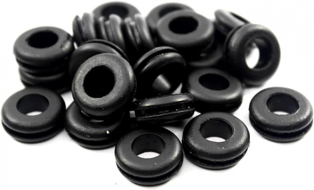

Do you happen to have a picture of this? I don't think I have a rubber grommet to use for placing this sensor in the driver side pipe.
N
312
127
Bear, DE, USA
mine was pre installed in the pipe. Looks like this:
Might be able to find one in a hardware store near by?
