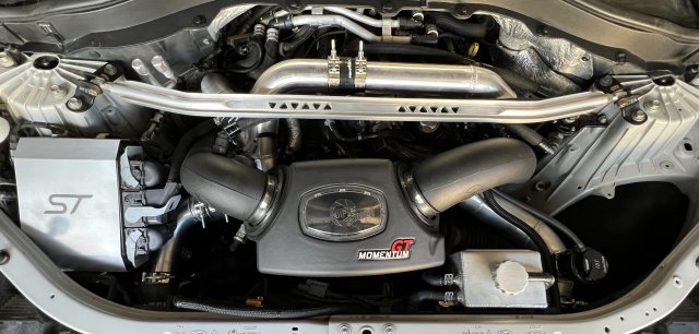

I have seen a few people adding the ECU cover from FENFAB and would like to offer, what I would consider, a necessary mod to the wiring harness that is mounted directly to the left of the ECU. The necessity of this mod is that if you do not move it a inch or so to the left on the radiator brace, the wires will rub on the cover and wear through the insulation on some of the wires.
Just pry the harness away from the current mounting location.
Size the two holes that are there with the appropriated drill bit. The holes are 2 different sizes.
Drill 2 new mounting holes about 2 inches to the left on the radiator brace.
Mount the wiring harness in the new holes drilled.

They come in different colors though i'm sure you could get it changed pretty easily with the right prep work.
