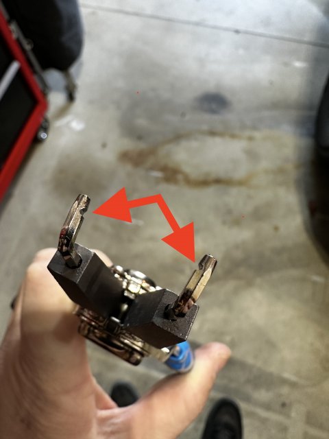

I installed my FenFab Charge pipe w/HKS BOV today on my 2022 ST.
Like you guys, there is only the video from "Knight's Garage" (referenced above in post #3) to go from a visual point. I don't work on cars or have a heavy knowledge of every hose and connector. The B&W directions you get from FenFab are pretty pathetic, but I guess they assume you know what you're doing.
While the video is excellent in helping you figure out how to change the factory charge pipe to the new FenFab one, it doesn't include the steps for a BOV.
The BOV should have a new rubber O-ring and a spring clip to hold the BOV on the charge pipe. This is the hardest part of the installation, to be honest. After 30 minutes of trying, I started Googling and couldn't find anything worthwhile. Some guys said it took them 5 hours, lol.
Here is my solution.
Buy these pliers from Home Depot; Channellock 8 in. Retaining Snap Ring Pliers

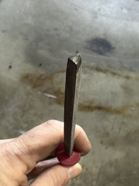

Then, insert the included silver, 90-degree ends into the ends of the pliers. Using a triangle edge file (pictured below), create 2 divets on the inner sides of both 90-degree ends like this.

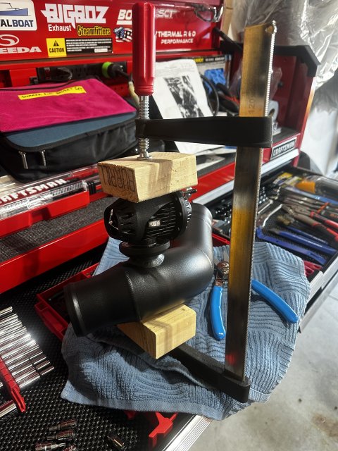

Doing so gave me a much stronger grip on the spring clip. The rubber O-ring was still pretty thick and didn't leave enough room for the spring clip to fit over the BOV in the flange.
Using an F-clamp and 2 pieces of 2x4 wood, I could compress the BOV safely enough to get the spring clip to fit with no problem and didn't bend or mark up anything.
Hopefully, this helps someone, as this forum has greatly helped me.
