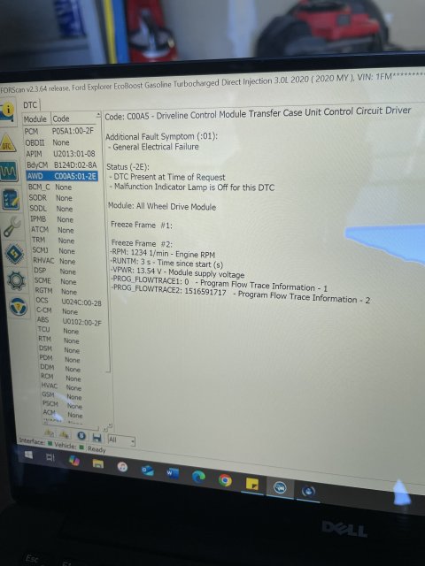

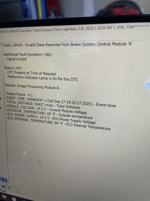

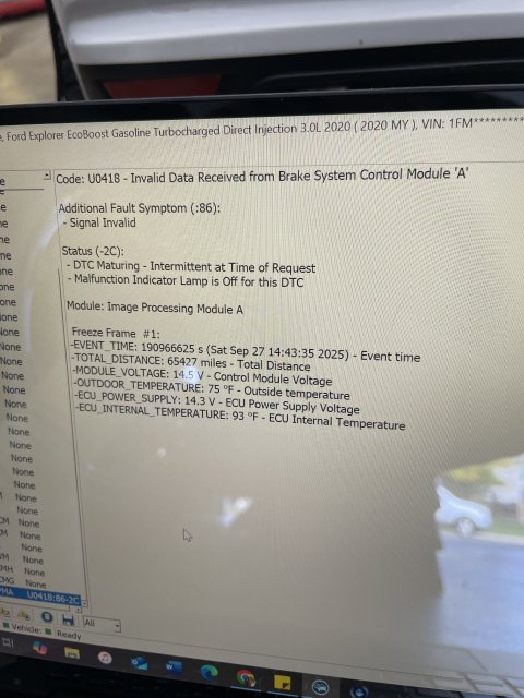

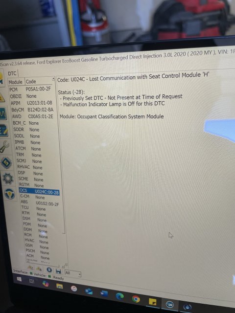

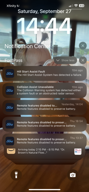

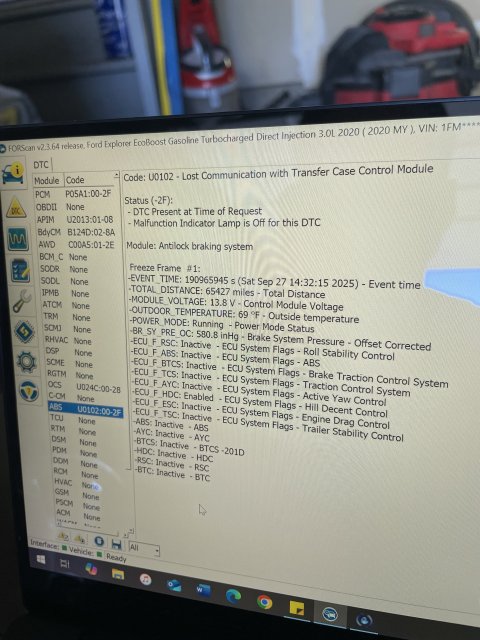

So my ST just started throwing multiple messages in my dash related to traction control, hill assist, collision alert and couple others. Anyone else experience this? 2021 ST.

you need to run a diagnostic in order to get to the bottom of this. Could be a few different things.
2,067
1,442
Could be as simple as a bad battery or worse. Codes would help immensely.

AWD module needs to be grounded, there was a recall on it.

I've had this 3 times: first it was the half-shaft speed sensor, second time was the FADA TSB, third was the AWD module. All of them were under warranty.

You either have to get it scanned (Auto parts store do it for free, or buy an OB2 dongle + app) or take it to the dealer. Those lights can come on for a few reasons.

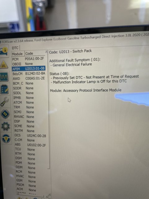

Nunya
I’m not the original poster but I think I have the same issue going on. I have load tested my battery 3 times at different places and it tests OK. But I think its the original 5yo battery. I might just replace it and see if it helps. After clearing these codes they didn’t come back. But i have random scary brake related malfunctions when trying to switch into drive or reverse which I think may be related to ABS module rebooting or something.
