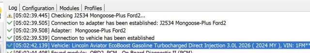

I wanted to post a quick note about disabling the fake engine noise in our Mid-March build ‘26 ST.
I downloaded the latest version of ForScan and went into the “APIM - Propulsion Sound Setting” and disabled it. This appears to have turned off the fake engine noise and now it’s much quieter in the cabin.
I also noticed that ForScan reported our 26 ST as a
“Lincoln Aviator EcoBoost Gasoline Turbocharged Direct Injection 3.0L 2026 ( 2024 MY )”
I was still able to make the change and it seems to have taken. This may be old news now, but from what I was reading when doing research it didn’t seem like this should have worked or it should have been this easy.
Does anyone have any feedback about how I disabled the fake engine noise?

It’s my wife’s suv, I changed the setting and took it for a drive and instantly noticed the difference. I came home and sent my wife for a drive, she said she noticed right away the fake engine noise was gone and how much quieter it is.
So I can confirm the setting change worked and I now have a happy wife. I wanted to post my success in hopes it might help someone else. Maybe there is a chance in the module for the 26 MY?
