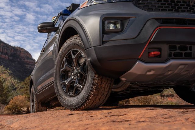

I would want the rims for a snow setup. Love those rims. 2021-ford-explorer-timberline-108-1620059693.jpeg

I would want the rims for a snow setup. Love those rims. View attachment 8699
If you have the standard 20" wheels on your ST, then you have the same brakes as the timberline and you can use those wheels.
Plenty of 18" rims fit the Street Pack. i would think the Timberline rims would fit. None available on eBay atm though.

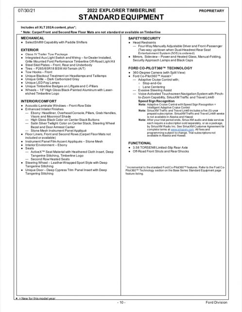

It’s right there in the Order Guide: 3.58. The smallest diff Torsen makes for Ford is/was 8.8.

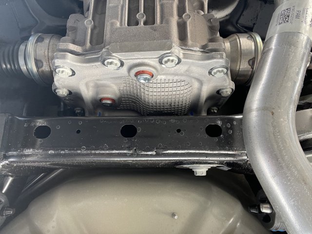

I know the difference, hence my comment that Torsen does not make them for Ford smaller than 8.8. If it helps your curiosity, here’s a couple pictures: 8.8. Same size rear sway bar as the ST, and this particular one has the thre-bolt cradle as well.

I think the telling point is the 3.58 ratio. While I'm no expert on ring/pinion diffs, there is a definite geometry relating to gear ratios available from different sized ring gears. Since the timberline has the 3.58, I'm making an educated guess it's the 8.8 diff and therefore interchangeable.

Are those pics from a timberline? If not they are meaningless. Also all the rear sway bars are the same size, so that means nothing either.
Yes, that is under a Timberline. And no, the rear sway bars are not all the same sizes. The ST/Aviator is 21.7mm, the others are 20mm, and the PD is 23mm.

That pic of the rear diff has no tag, just because it looks the same, doesn't mean it is the same.
