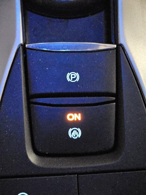

I think OP has been driving around with this on

I don't have an ST, but have a 2022 SLT and had a similar incident occur to me on Sept 9 while sitting at a red light for several minutes. I was utilizing auto brake hold and Co-Pilot features, and while sitting at the red light, the vehicle disengaged and accelerated forward into the vehicle in front of me. I took it to the dealership shortly after the accident and, after doing diagnostics, they confirmed that there were several error logs in Co-Pilot system approximately 40 minutes prior to the accident. The technician was concerned that doing a software refresh may not correct the issue, so he reached out to his support center. The vehicle was instructed to be parked and not driven and a report with Ford Corporate was filed. The vehicle has been at the dealership since Sept 16 where nothing more has been done. The dealership stopped receiving any additional communication from Ford in October. I filed a report with the NHTSA and they are actively investigating. I am also pursuing a legal investigation.
