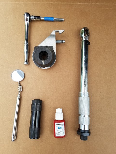

Mine had a horrible metal-on-metal rattling sound the day I drove it home. Determined it was outside, driver's side, in the very rear. Crawled under there to find 1/4" gap between the last exhaust hanger and the body.
The bolt would not tighten. I worried that the body insert was stripped. So I chased the 8Mx1.25 threads anyway and crossed my fingers. The long bolt then threaded in all the way. So I put on some blue thread-lock and tightened it just past snug (about spark plug tight), so as not to risk stripping the threads any further.
Been all good so far. Pic of everything I used to effect the repair.
