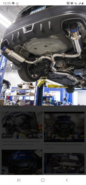

I am fully aware I might get roasted for this, but I'm willing to take that chance...
Since this is a V6 and all, and I've even heard others say it almost has a GTR-ish sound with aftermarket exhaust, I was curious what everyone thinks of doing an x-pipe setup to 2 canister style mufflers? I was thinking something crazy like Greddy SP mufflers or something... obviously the picture is a Subaru with single piping to the mufflers, but I was just thinking some kind of straight through mufflers with a single large tip, preferably black, might look sweet and sound good...

Mine will be 3” SPD downpipes with the reducer cut off into all 3” piping with an X-pipe Magnaflow muffler and a pair of resonators out back with the tips welded directly to them. The only different in what you’re describing is the tip style. The rectangular opening in the bumper is 9” wide so I think a single round tip may look out of place.

if you want a more GT-R sound, skip the canister style muffler and just use a couple helmholz chambers. this setup plus a simple x-pipe further up the stream would be amazing and get you that more higher pitched braaaap sound.

Helmholtz chambers / j-pipe resonators don’t change the sound much. They target a specific drone frequency to kill it. I’ve used them many times and they work very well.

Yeah, I don't really know exactly what I want to do, to your point, finding a single tipped muffler that doesn't look too small in the large opening, will be difficult... I'll probably just go with an x-pipe resonator to straight pipes, out the back, with dual tips.
