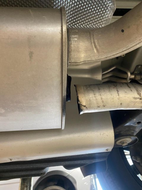

My 2020 ST has 48,000 miles. Last week it started to sound like a sick hoopty. Low and behold, one exhaust pipe broke clean off from the muffler. Seems like an emissions warranty item, yet I'm reading through the list of coverage and it is not listed. What the? I drive a lot of miles and may be the first to find the weak spot, but reading all the comments about exhaust vibration make me wonder if this is related. I did not hit something in the road to cause this.

Seen lots of them break there and at the converters. 5 minute fix at any muffler shop….which is so way before I’d waste days fighting Ford to fix it.

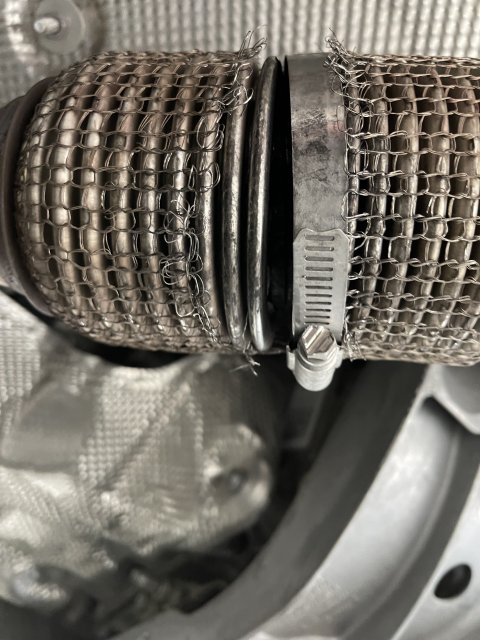

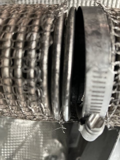

I just noticed this today, the band clamp on the flex pipe was loose and rattling so I was going to tighten it and realized that won’t fix the rattling… see pic of the flex split. Local Exhaust shop is going to replace the flex pipe tomorrow for 189.00….. better than spending 400-500 dollars for the Ford OEM passenger side tube. Has anyone experienced this issue?

The same thing happened on my 2020 model with 43000 miles in the exact same spot. Took it to the local dealership and they wanted $250 to weld it back up and wouldn't do anything warranty-wise because there was a dime size dent in the muffler. Told me I must've hit something causing it to break. I declined and took it to a local muffler shop who welded it back up for $60. The dealership did notice hairline cracks around both catalytic converters during the tailpipe inspection and is replacing both under warranty. Still don't really understand how they would replace those but not repair the tailpipe. It's obvious the tailpipe material is too thin wall for that system. If something small enough to put a dime size dent in a muffler would cause a complete breakthrough of an exhaust pipe/muffler weld, I'm ashamed for Ford.

same thing happened to my 2021 ST a couple of weeks ago. Took it to the dealer and was quoted a price of $3800 for new muffler. Eff that. I talked to the service manager and lo and behold, they could weld it after all. Sounds like a common problem. I’ve never been off-road or over crappy roads. My first Ford was an ‘84 Ranger and I’ve had fords ever since. I’ve seen the erosion of quality
