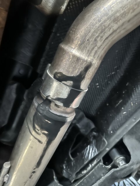

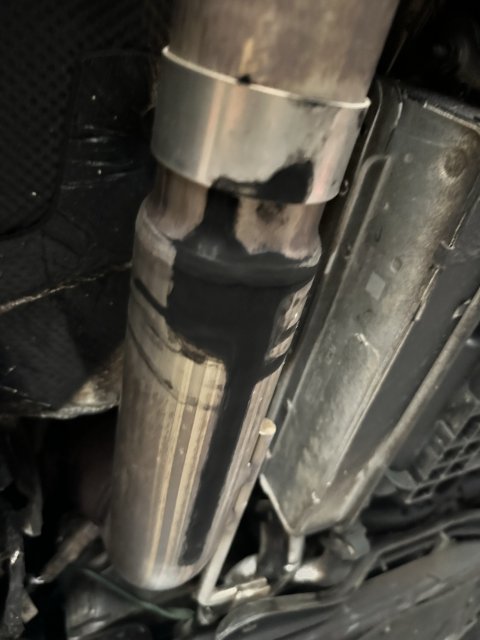

Well it looks like I do have some leaking Any suggestions? Weld?
2,122
1,074
2026 Explorer ST
Those clamps need to be super tight. I used a breaker bar because the car was not jacked up...otherwise I'd use an impact wrench.
5,770
6,980
Tighten the clamps again but condensation/soot seeping out is fairly normal.
Any recommendation on torque? Don’t want to smash the pipe lol

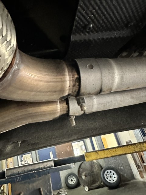

the OE exhaust that you are mating your midpipe to have slots in them (or at least my early MY2020 does). make sure the midpipes are inserted far enough past those slots.
That style of clamp won’t smash the pipe. The bolt will break well before that.
