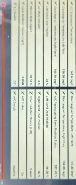

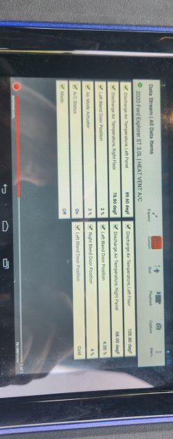

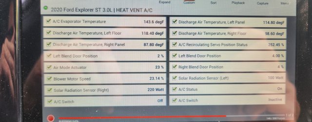

I'm stumped at an issue I'm having with hotter air blowing from the drivers vent compared to the passenger vents, the drivers blend door actuator works to go from hot to cold, I have removed the drivers blend door actuator and manually rotated the shaft/door and everything moves as it should but hot air still flows through.
I attached a few images of the temperature flowing through each vent..
Any suggestions would be appreciated.
