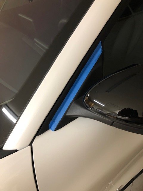

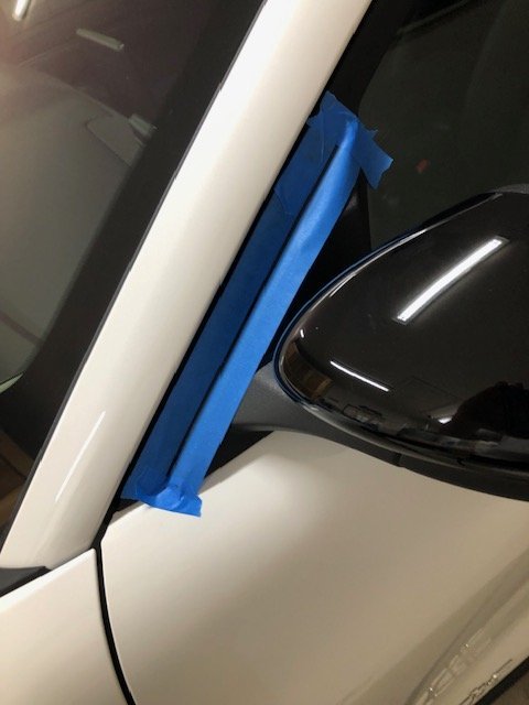

Just an FYI. On my Mach-e the wind noise at the driver side mirror was driving the wife crazy. Did some research and experimenting and found the wistle was air getting in the crack at the connection of the mirror housing and the door. Fixed with a bead of black caulking in the crack and no more whistle.
All that to say the mirror set up on my ST is nearly identical to the Mach-e. Might be worth trying some tape on that crack (be sure to seal up both ends) to see if it helps.
Pics attached of Mach-e "repair"
View attachment 19946 View attachment 19947 View attachment 19948
My 2020 whistles so bad, luckily I drive with the windows up. If I fold the mirrors, the whistle goes away. My wife's 2022 does not do it. I'll have to try this one day.
