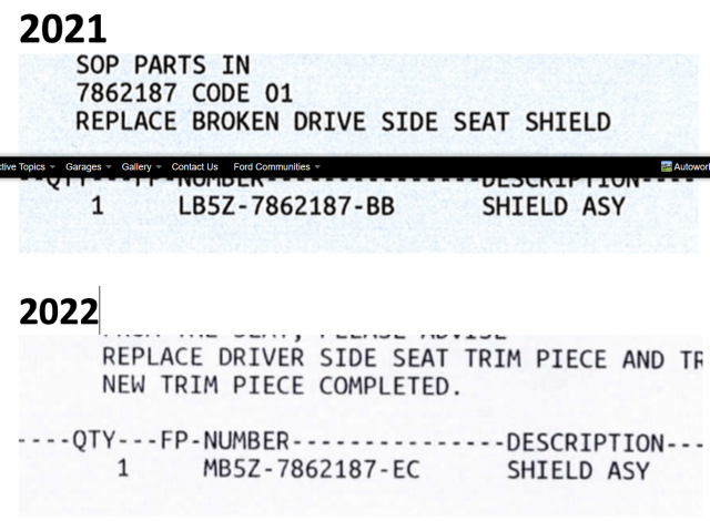

Mine was replaced under warranty and I knew exactly when I broke it. I ordered it, and it arrived in a couple of days, pulled the old one off, it takes about 10 minutes, and took it to the parts counter. I gave them the old one, they handed me the new one, I took it home and put it on. I think there was a CSP on these for the 20 and 21 model years. They have been redesigned, I made sure my new one looked different than the old one. There is a thread somewhere on the site discussing this.

Poor design and cheapest plastic possible! I have Tupperware made of better plastic! I thought I made sure it was the new part number but apparently wasn't.

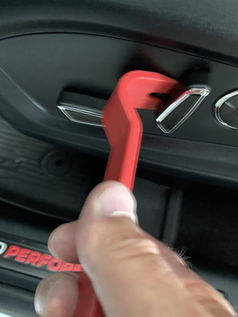

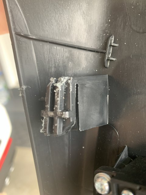

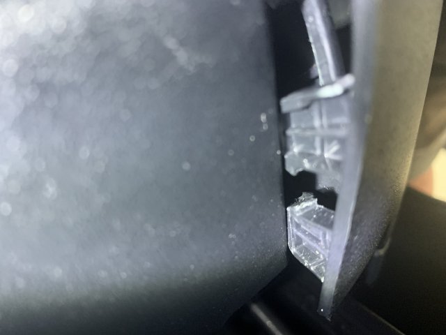

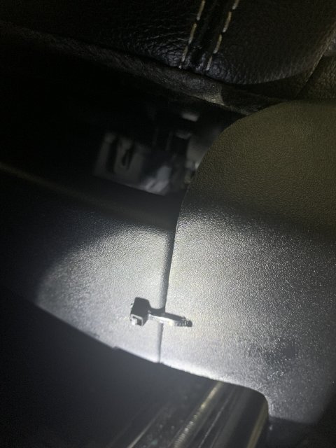

So, It turns out my panel wasn't broken. When the tech replaced it, he missed the top tab. It was being held in place until...the front panel broke. Re-installed the side panel (correctly) and Meguivered the front panel in place. I added the lever pic to show the controls can be popped off with a trim tool.

Turns out mine may not have been broken either. I popped the side piece back in and it's stayed in place since yesterday.
