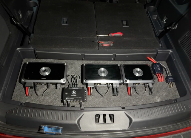

I have 3 JL Audio VXI amps in the back (Class D). I guess if they were A/B this wouldn't be an issue? I can see how this might cause an issue when the car is still powered on (just got out and shut door) and is NOT an issue after it powers down (amps/system is off).
Now… I'll say I ran the ground wire all the way back to the battery because the navtv f25 device stated it had to have the same ground as the amps. One of the fixes is to shorten the ground wire.
  • Relocate the Ground Wire: Ensure your amplifier ground wire is as short as possible (under 18 inches) and bolted directly to bare, unpainted chassis metal. A weak ground forces RFI to escape through the power wire instead of safely draining into the vehicle chassis.
Another is to clip ferrite cores close to the amp chassis… I don't have the faintest idea of where to source those. Amazon?

I was POSITIVE the wire wasn't acting an as antenna… but I'm not so sure now after being told that the received is in the rear (where the amps are) and that the switching is what causes the radio interference. The FOBs work perfectly after a bit of time (system shutdown) and only have issues when powered on. TPMS sensors (obviously) only trigger after a bit of driving and then tech said when power wire was unplugged from batter everything functioned fine.
I'm not sure what to 'believe' at this point but WILL shorten the ground to somewhere in the rear (hoping for existing bolt or something). I have some spare wire… maybe I'll use that to confirm before cutting current ground.

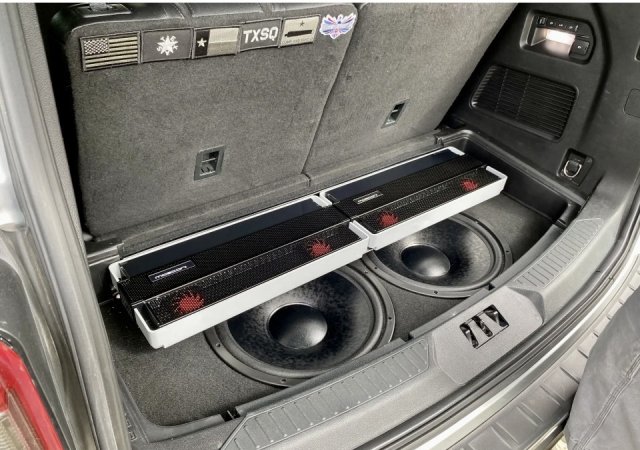

Anyone have experience/past success with ferrite clips? Apparently the fob and tpms sensor receiver is located in rear pillar and my amp location is the biggest problem. REALLY not wanting to relocate to underneath seats.
C
St Louis, MO
2025 ST

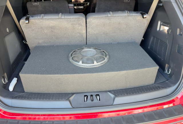

And then (this is all info from AI) having the sub on top only amplifies rf waves. I've NEVER had to deal with this before (these are the first class d amps I've owned).
5,773
6,982
Big Class D sub channels in exactly the same place your amps are. Zero issues. Never even heard of your issues being amp related…still not convinced it is. Since all you have to do is unplug the amps to test have you done that? IMG_0545.jpeg

Yes, @UNBROKEN unplugging the + battery wire solves the problem (fob and TPMS).
@JADE97 I suppose I could check individual amplifiers (remove fuse from dist. block) to see if that's the case.
