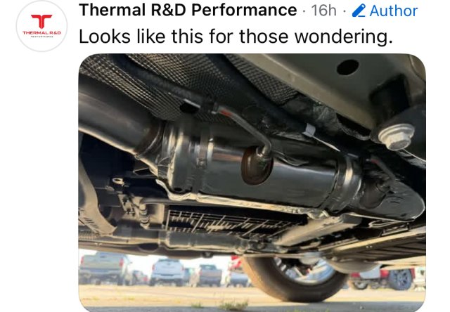

I just ran outside and checked mine it does not look like that at all. SOOOOOO all in all im pretty happy about that. I guess when it comes around to doing whatever I will be doing I can just do it ......Like NIKE

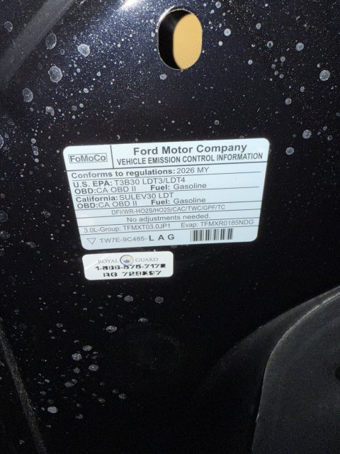

4/13/26 build date forward for 17 CARB-adopting states plus Washington D.C., including: California, Colorado, Connecticut, Delaware, Maine, Maryland, Massachusetts, Minnesota, Nevada, New Jersey, New Mexico, New York, Oregon, Pennsylvania, Rhode Island, Vermont, Virginia, and Washington.
Check the VECI sticker under the hood (it will list "GPF" if present)
