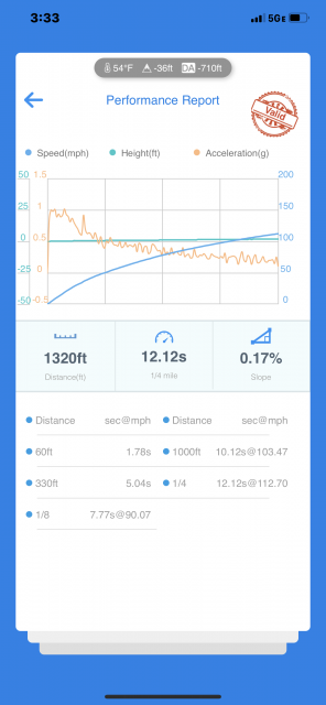

ZFG 93 tune, Whipple IC and drop in air filter...added SPD downpipes and full 3” exhaust...best 1/4 before was a 12.24 iirc. This was with no adjustment to the tune and launching at 2700 so the 60’ was a bit slower than my best 1.74.
We’re fine tuning the 93 tune now but I’m waiting on dry roads again. I believe this is the quickest 93 tune pass anyone has made to date.

That’s a really good DA too. What was the DA on your previous run?
Is that 60 ft of 1.74 vs 1.78 a big difference? I know that a decrease in 60 ft is supposedly equal to two times the decrease on a 1/4 mile time, but on an unprepped road it would seem .04 seconds is within a standard margin of error.

The 12.24 was also in good air and negative DA.
Picking up over a 10th with no tuning changes is solid. We’re gunning for an 11.99 on 93 though.

For a 4700 lb car it looks like it makes about 12 hp difference using the 1/10 gain in ET and the following simplistic equations:
https://www.gregraven.org/hotwater/calculators/hp-from-qm.html
Actual weight on one dressed like mine is right at 5000lbs. That would put it at 16hp...keep in mind that’s the same tune as before the exhaust. We’re working on the post DP/exhaust tuning now trying to crack into the 11’s. An 11.99 would show a 30+ hp gain...we’ll see what happens.

I wanted to have the exhaust done before switching to corn...but now we’re curious to see if we can tag an 11 on 93. And I won’t pull anything to do it. It’ll either make the number or it won’t but if it does it’ll be at full weight.

In your opinion, do you believe the gains are from the downpipes, the 3" exhaust, or maybe a combination of the two?
5,136
6,160
I personally don’t think the DP’s feeding into a stock sized exhaust has as much potential.

I think it’s close to a wash on weight. The oem exhaust was surprisingly heavy. I thought I’d be adding weight for sure but now I’m not so sure. It’s all a guess though...I didn’t actually weigh anything.
