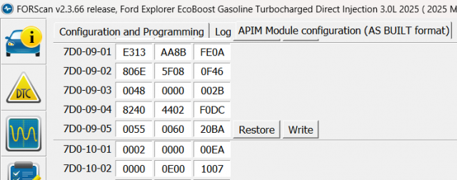

So, I tested it again.. and this looks right to me, 6 was changed to an E, but I could be wrong. Still shuts off, I get the 30 second countdown on the dash.
