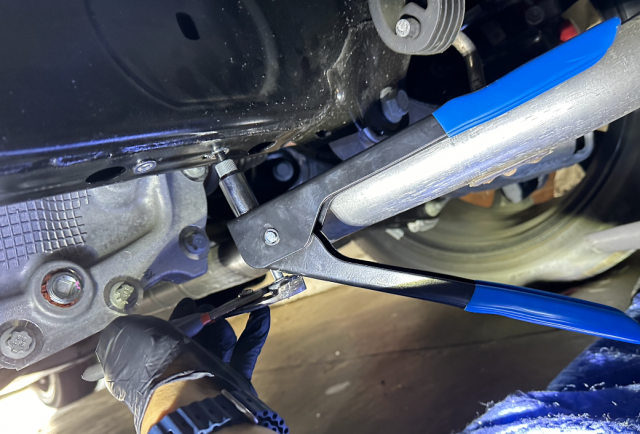

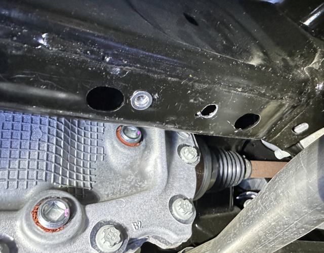

Second solution I explored was a Nut Rivet Tool, M8 specifically since the Fenfab comes with M8 bolts. I tried utilizing the smallest drill bit to make the hole bigger to insert the rivet, but ended up using the 1/2 drill but which worked perfectly.
https://a.co/d/dzroY75
*This link is now updated for steel rivets
I followed the instructions and now the brace is torqued on there, my rivets are installed and I am happy.
If you are doing this for the first time, I recommend drilling the initial holes first with the brace with the small recommended drill bit, then taking the brace off, and widening the hole with 1/2.
I also learned the hard way, when utilizing the rivet tool, compress the handle so that you can easily screw out from the rivet. I utilized pliers on the knob and it took forever for the first rivet.
