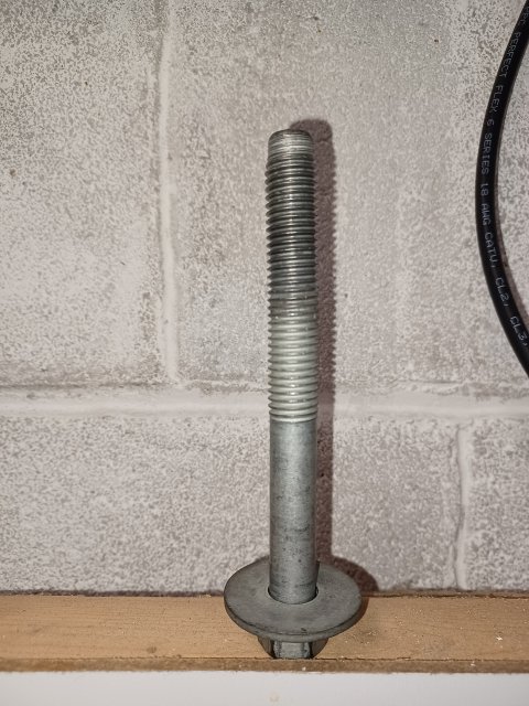

Look what we discovered while installing the differential brace?
A bent bolt!
I gotta say while I love this car Ford service and quality are very questionable!
Get under there and check your 3 bolt setups if you have em.

Hopefully the new part is indeed stronger!

This doesn't surprise me at all. Looking at the video Steeda posted with how much the subframe moves during acceleration, I'm surprised these 1-bolts don't snap more.

Ordered a new bolt (W720988S439) on the 8th from eBay for $11.54, it delivered yesterday. Going to crawl under it today and swap it out. Can someone confirm the torque specs of 148 lf/lbs?

When these bolts finally break, is it a result of fatigue.... where eventually a crack starts and then propagates across the bolt over time? Would it make sense to loosen the bolt a half-turn periodically, then re-torque? Any bend in the bolt should show up as bushing deflection (and/or diff movement) when the bolt rotates.
