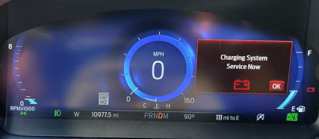

I got this message about 20 minutes after parking following a 35 minute drive, so the vehicle was not sitting for 14+ days (never has), about 45 degrees and the battery was fine. I started right up no issues. It's only happened one time. I have heard others mention this and a possible TSB. Called the dealer and they have no information. The build date is June, I have owned it since September. Anyone have any experience with this and information on how it is fixed? TY e20deepsleep.png

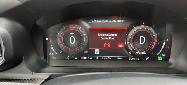

That same message happened to me before the car failed to start. Something was drawing the power from the battery while it was parked for a couple days.
Really liking this warning from FordPass about my car before it takes a dump. Clever girl!

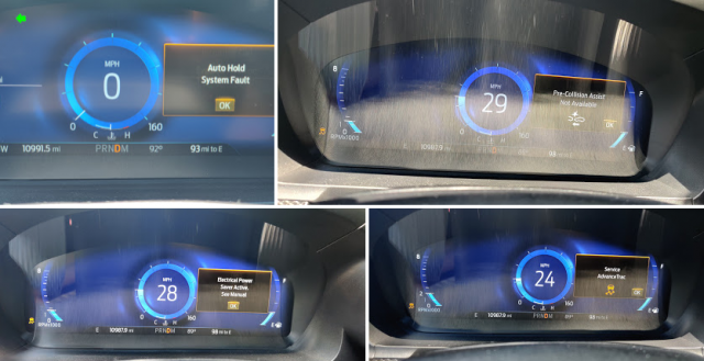

UPDATE: Parts came in for the heated driver seat. Drove over to my scheduled appointment. And One block away from the dealership, the CHARGING SYSTEM SERVICE NOW (battery) error showed back up on the dashboard. First time in a few weeks (since they fixed it in the software update). The good news: The dealership traced it to a loose wire on the ground near the passenger side controls.

Got the car back today. No more CHARGING SYSTEM SERVICE NOW message. But this is the 4th time picking it up being told it’s fixed. This time, Ford tells me it was a grounding short. Should be fixed now. :rolleyes::rolleyes::rolleyes:
