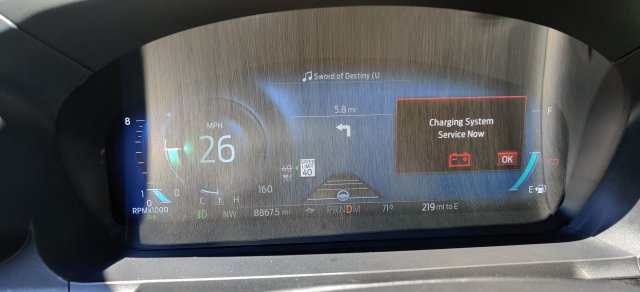

Anyone run into a "Charge system service now" alert on the dashboard before?

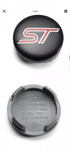

I am looking for an ST wheel cap (red font with black background). For whatever reason, my car came with one Ford wheel cap and 3 ST wheel caps. Looking for a part number...
Yes, it came up last week. Shut down the ST and tried a restart. Came up again and disappeared. I made it home (half hour drive) without problem. Shut down ST for hour. No more issues on restart.. I may have been using the auto shut off too much and not letting ST charge up enough while in traffic.
After sending this to mechanic @ Ford (Ford said the TSB isn't the right # but it is a known fix to that warning message), they said this should fix that issue:
TSB #48268 - 2020 Explorer/Police Interceptor Utility - Discharged Battery/No Crank - Built on or before 30-Aug-2019. The Bulletin states, "Some 2020 Explorer/Police Interceptor Utility vehicles equipped with SYNC built on or before 30-Aug-2019 may exhibit a discharge battery/no crank condition. This may be caused by the software in the accessory protocol interface module (APIM), body control module (BCM) and/or the telematics control unit (TCU) module. To correct the condition, reprogram the APIM, BCM, and the TCU using the latest software level of the appropriate Ford diagnostics scan tool. If the BCM software update is not available in the FDRS Toolbox, a software fix is being developed. As a temporary fix, uninstall and reinstall FDRS selecting 'remove all data'. If the battery drain concern is still present, follow normal diagnostics in Workshop Manual (WSM), Section 414-01 > General Procedures. Effective Date: 17-October-2019."
The mechanic said 2 of the 3 device softwares were already up-to-date. They updated the 3rd (BCM) needed updating. Haven't seen the error since but need to test this on a long trip again to be certain.

Something like this. The stock one for with the ford one emblem is 6M2Z-1003-C
That is EXACTLY what I'm looking to buy! Much appreciated!!!
I'm having trouble finding that part # in the picture. What is that # 6M2?-1003-AAal
Can't find that part on Ford's website.
UPDATE: Called local Ford dealership, he is tracking down that part # now.
