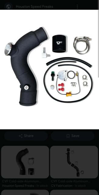

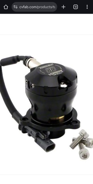

I recently ordered a cvf intercooler kit with both side charge pipes and a turbosmart bov. But I dont understand how the 3 bolt bov mount to the coldside pipe that doesn't have provisions for the bolts pass through. I may just be a dumb-dumb but I dont understand how to mount it and i want to make sure I have everything I need before I got to rip the car apart
I attached some pics of how the pipe and bov look (I believe the flange on the charge pipe looks slightly different than that but very similar.)

Thats because you have to irder a 24 intercooler to run the charge pipes
Phoenix, AZ, USA
Adding a question on that I can't seem to get good details on: what exactly is different between 20-24 and 25's intercooler and charge pipes? I have the intercooler and cold side pipe from my 22 and curious what the compatibility is on which parts exactly.
