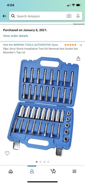

I went and bought some cheap pass-thru sockets so I could hold the shaft while tightening. Plus I didn't need to take the wheels back off. The passenger side need a little tightening. But the driver side was a bit loose.
Thanks for the help.
