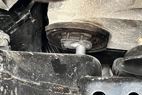

You can see where the spring was hitting the sway bar because it was off the perch! Then, after they did the transmission I was hearing a clunking sound right under my feet. Took it back and same thing, they couldn't find anything. The noise went away so I didn't think much about it. A couple weeks later we had it on the lift again for something and I found this:
That's the left rear engine mount! They stripped it out and it was moving up and down causing the clunking sound until it finally jumped on top of the bolt! Needless to say I didn't bring it back! I just ate it and had my mechanic fix it. I was affraid to bring it back in to them. So you're not alone. It sucks you have to roll the dice bringing your vehicle in to a dealer. Hopefully your new shop treats you better.

That sucks man! My dealer screwed something up on my vehicle just about everytime I brought it in. After they replaced the rear differential I kept hearing a noise in the rear right of the car. Took it back and they confirmed the noise but said they couldn't find it. Took it to my local guy and we put it on the lift and found this:
Man was there a bunch untrained techs working on this?
That’s totally unacceptable. I would take the pictures to the owner of that dealership and demand a total refund.

I did take pictures to the service manager and he just said he would show them to the tech so he would know for next time. I thought about taking it to Ford but decided it probably wouldn’t do any good. I just don’t go there any longer and try to steer people away if I can.
I would send them to Ford and fight this.
You’re lucky that didn’t cause you to wreck injuring/killing you or someone else.
That is total sloppy half ass work that was done to your vehicle.
How many other customers have they done this too? Makes a person wonder. Unacceptable in my opinion.
