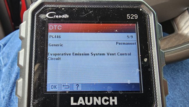

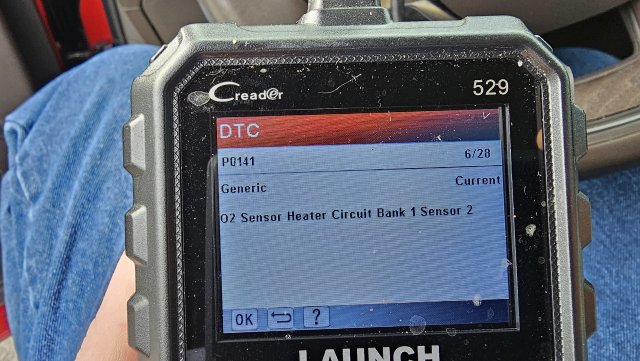

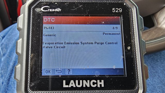

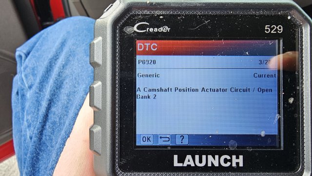

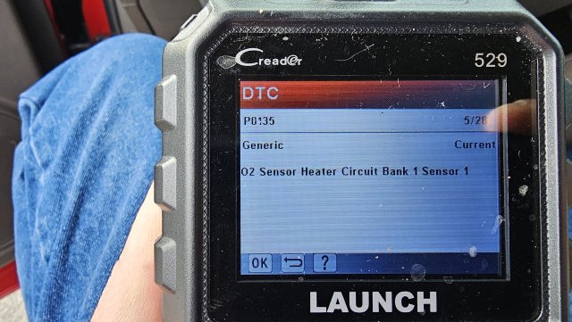

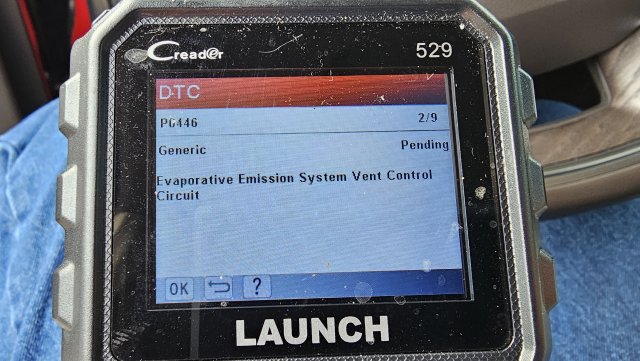

Anyone ran across a situation like this? 2020
Power is down in the lower RPM range but normal up top.
I can't help but wonder if there is a common cause for the cam sensor and O2 codes.

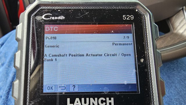

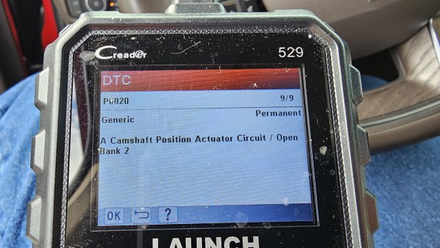

Ok, did some digging and fuse 7 under the hood controls all of the emissions and O2 sensor stuff. It was blown. Replaced it and cleared codes. The o2 sensor and emissions codes did not come back, but the camshaft solenoids are still in permanent status. I have to go through 4 drive cycles before permanent codes will clear.
Does anyone know if there is a common ground or something for all of the camshaft solenoids?
