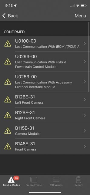

Good thing I scheduled my appointment to have this fixed. I have a bunch of DTCs, that I think are related. Not all of them, but a lot of 'em. Unrelated, but my side mirrors won't open now. lol, pressing the button does nothing.
What program are you using on your iPhone?
Reset all of them, see if it goes away or re appear shortly.
Maybe it just a glitch in the Matrix
