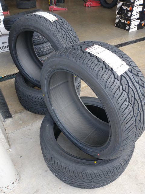

Went in for a tire rotation today and the Pilot SS tires are done. One year and 15k miles, yikes. Going to upsize to 305/40/22. Will report back on any rubbing issues. This gives me the opportunity to swap out that curbed rim at the same time.

First impressions are fantastic! The ride is way smoother than the Pilot SS tires an NO MORE TRAMLINING! Holy shit, this is so much better at less than half the price. No rubbing on anything. Will report back on these after I put some real miles on them

That is something I knew going into this. I bought the Pilots thinking that I would be thrashing them in the corners and banging off the line.The truth is that it was all regular miles. As long as my wife is the main driver, these tires will do the job just fine. Plus the Pilots were really shitty in the rain and always felt on the edge of hydroplaning on these wonderful Houston freeways.

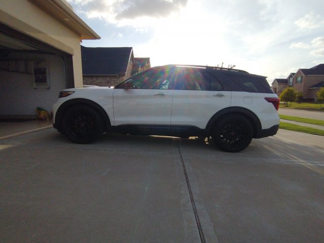

I am lowered on Lethal springs.
I ran the Pilot's until they wore down and have to say that they are not for a daily driver. At over $2k a set and only lasting 15k miles, it is not worth the money. The Yokohamas that are on the ST are leaps and bounds a better ride and absolutely no tramlining. No rubbing at all so far. I'll report back on how the Parada's handle and hold up after putting some miles on them.

Lowering springs don’t effect if a tire rubs or not. It just lowers the suspension the same way hitting a bump in the road compresses the suspension. It is rim and tire specifications that effect rubbing.

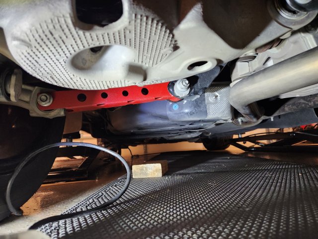

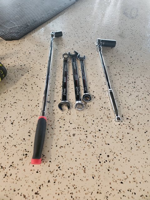

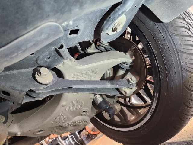

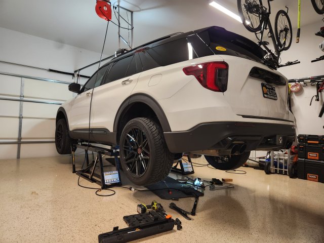

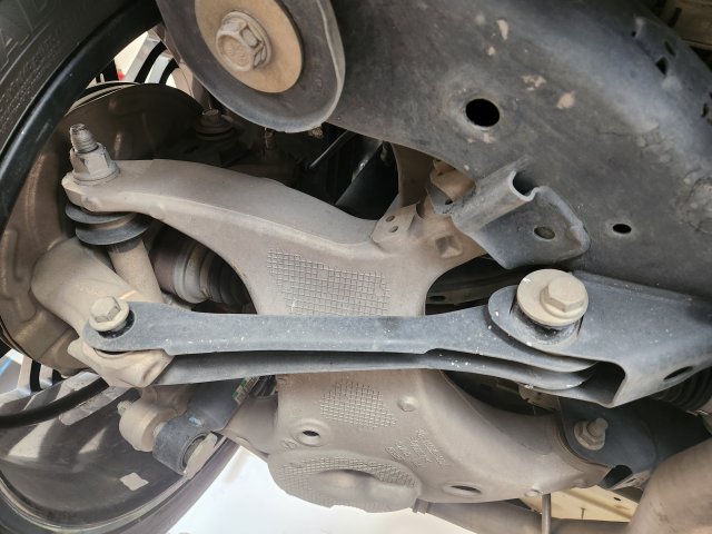

Installed FenFab rear toe links today. Not all that difficult but make sure you have at least an 18" racket or breaker bar to remove the inside bolts. Mark the alignment tabs so you know where to tighten down once they are installed. Already have an alignment appointment tomorrow to make sure everything is just right.
Did not totally eliminate wheel hop on a hard launch, but reduced it drastically. Almost gone.

Sweet garage setup you got there!
Thank you. My wife is very understanding of my car addiction...lol

In case anyone wonders for their own install…you don’t need the wheels off the ground to install these. Ramps help for a little more room to move around but the weight can be on the ground.

I have about 1,300 miles on these tires now. Have to say that so far I'm completely satisfied. Waiting for some rain to come through this week so that I can se how well they do in the wet.
